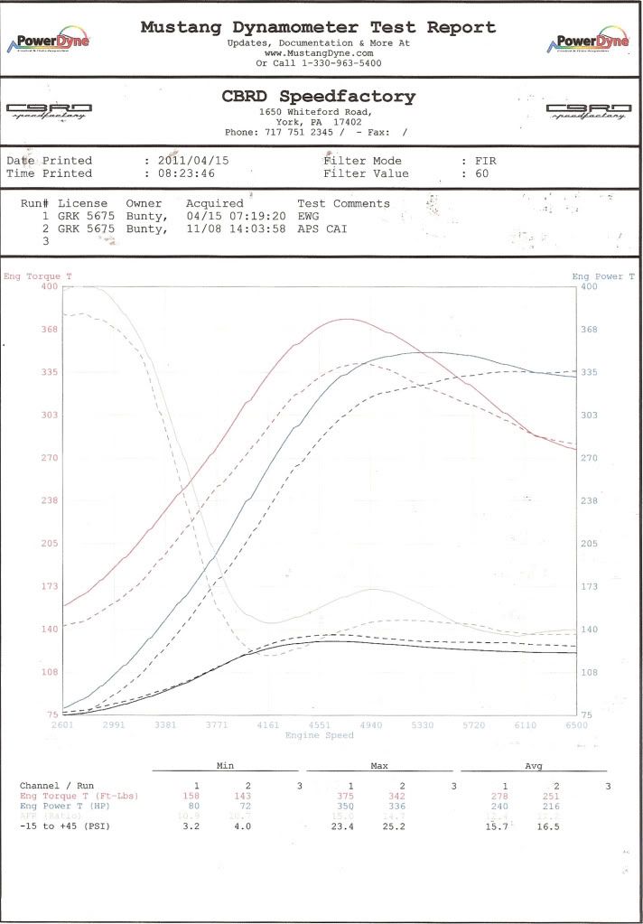

Sadly the fastest spooling turbo that will make 330whp/340tq that could be pushed to 400whp with E85. Would either by my turbo the Dom 2.5XT-R rated at 490 crank or the Blouch 20G-XT rated at 470 crank. The difference being the Dom 2.5XT-R is ball bearing and that helps spool up over thrust bearing turbos. Btw, you will need a butt load of money to get what your aiming for too. If you do a engine build, just get head and cam work done. I'm regretting it now and now I'm contemplating going backwards and doing headwork. Which will require the engine to be pulled again.
Btw, that's basically max crank hp figures that blouch came up with. Idk if they have a engine dyno or not. I tried to take a tour of the shop and was blindly shut down at the front desk by one of the blouch boys. They fear that shop secrets will get released with public traffic, photos being released, and insurance reasons that they don't want public by standers to get hurt.
All that I know is that Mike Blouch runs a Dom 3.0 on his car. My tuner has worked on his car and I didn't pry further to see if it was the upgraded Dom 3.0 or not.
