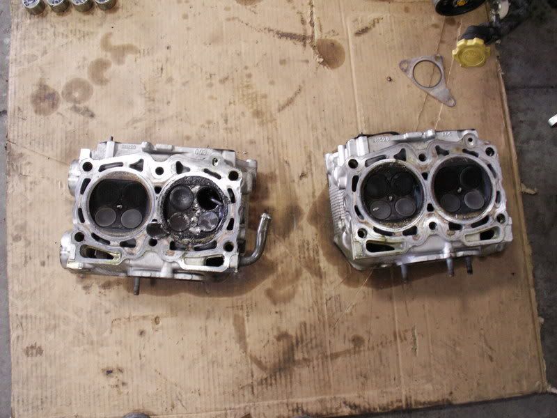

This started out as a simple turbo swap but a few nights ago I threw a Valve from my EJ20 heads in to Forged EJ25 short block...I don't know exactly what the damage is yet (we are going to pull the motor Monday or Tuesday) but I just went ahead and got all new parts for this build and I am going to sell off everything that is not damaged.

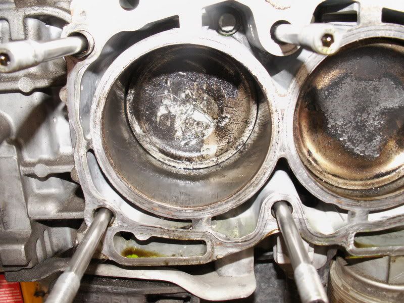

Can You Say Blown The F Up

that's not a pic of the built ej25 you're doing is it? hope its the old one. the reason for the rebuild.
No that is the built short block I already had and the stock EJ20 headers that through the valve...it was one of the factors that lead me to completely rebuild everything...shooting for the big horse power numbers
