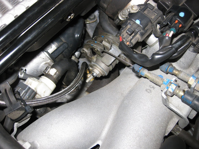

The premium gauge sender should fit in the galley plug under the intercooler. The sender for the regular version of the gauge is much bigger, and when I installed it I broke the first one and had to order another. I got the remote sender and it's much easier to see and replace in case it gets a leak or breaks.
It's been over a year and it's still working great, so I'm happy.
Here's a tip on a tool you'll want to install the gauge. You'll want a crows foot wrench or else it will be very difficult to get a wrench on the sender nut.
It looks like this.
As you can see it's pretty tight down there, so the remote sender is worth it.

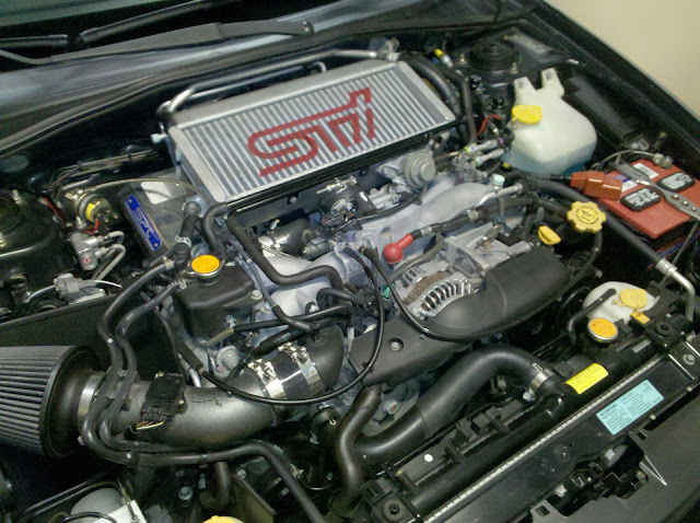

You can see the remote sender and the size of the "Performance" gauge pressure sender right next to my SPT turbo heat shield.
Enjoy. I've had good luck with my gauges considering the cost.

Thanks blk05WRX. The second pic is the exact spot where I'm probably going to mount my sender. I do have the premium series Prosport oil pressure gauge, so I don't have the bulky gold sender that's in your picture. Mine is just a little clip on a little nut which should easily fit in that area. It's also probably going to be easier to route the wire from the rubber grommet in the fire wall directly to that spot instead of having to route it under the engine to the oil filter, had I been able to use the sandwich adapter. The remote sending hose looks like it was meant to be installed in that location - sweet engine shot.
