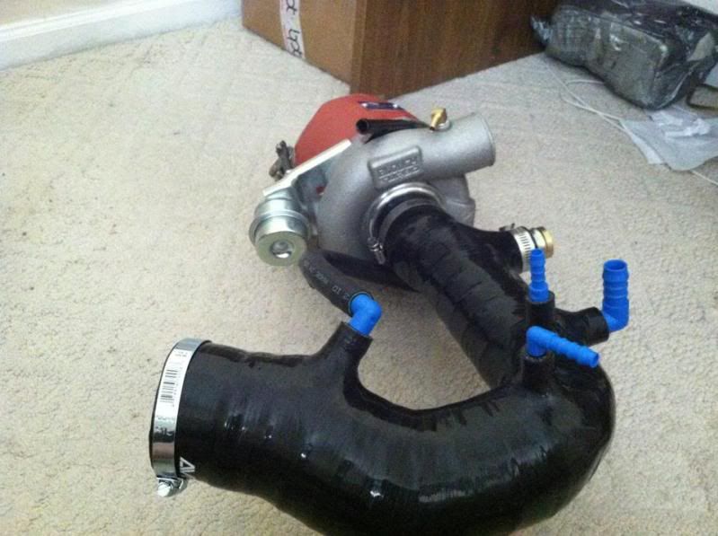

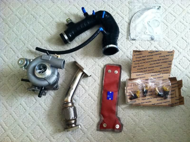

After having the STi for a little over 2 years i finally got the money to buy a Blouch 1.5xtr. Im so excited to finally get back on track with modding my car. The VF39 took a dump a few months back so i havent hit boost in quite a while. Once i get my turbo ill be getting madddad uel headers, heat wrap, turbo blanket, 850cc injectors, amr turbo inlet, and kstech big maf intake. hopefully after i get my retune i should be somewhere in a mid 300's which is perfectly fine with me. Once thats done its time to go low and get some wide xxr527's and gid rid of that park bench. This is gona be a fun summer
