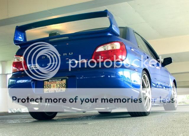

Well, I bought the car used with the mods on it already. But the downpipe obviously has to be bought from www.godspeedinc.com or bought used from ebay or nasioc. The HKS exhaust might be bought off ebay or nasioc for cheaper. The DP has not cats in it. But it has the mechanical CEL fix so you don't get a check engine light. We have emissions up here also and I went through it with no cats and it passed - because I'm not throwing the P0420 code and becuase they were drooling over the car so much that they forgot to do a visual inspection. They can't put it on the rollers because it's AWD, so they can't/don't do a sniffer test on the car. Here's a pic of the exhaust...

man thats bad ass how much is the car lowered... i need to lower min a lil.. its sitting in the clouds.... im used to driving body droped trucks..... lol
