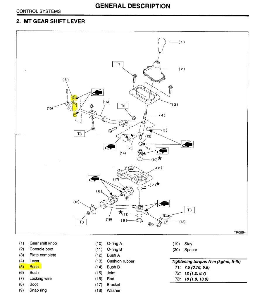

im looking for a website that i can order all the odd ball parts for the rex. for example im looking for the gasket for the rear diff,also needing a bushing for the shit linkage setup.small oem parts that most major auto parts websites that dont offer. i done dealing with my local subaru shop being that they have ripped me off many of times,there shipping is sub par and never call me when my parts are in. look at the pic attached. im looking for the highlighted parts. but the part list only list the 2 washer items which im needing the center rubber bushing. any help would be great on any websites that i can order these items at. thanks

35047AC030
Bushing is not a separate piece, it comes pressed in the metal assembly. Part 15.
