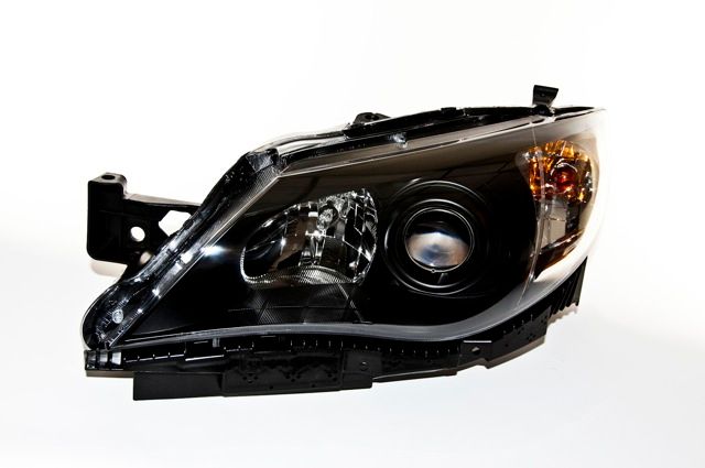

Ask man show I think he already did this mod and I know a website that will do it for you. Haha or you can do it yourself. Something like this...
or you can have HID Projector Headlight Retrofit for Subaru, Honda, BMW, Scion and More | LightWerkz.net do it for you.

Yeah, they are a bit pricey though. Plus, you have to send them your headlights or I assume your spare pair that you had to purchase. Just to mod. Man show I think just painted the inside of his. I'd have to get him put up a picture of his.

^ Woo hoo! I'm famous
Yeah, I just painted mine. Here's the link I used: How to clear 06 headlights & paint. - NASIOC
I just used several coats of Duplicolor Universal Black spray paint (no primer, no clear) and used blue painter's tape to carefully mask off the chrome rings around the low beam projectors. So far, no chips or cracks, but probably some fading.
I also installed chrome/amber turn signal bulbs which I found on eBay so they blend in and look chrome when they're off during the day and they light up amber when they're blinking to keep it somewhat more legal. I kind of damaged the plastic edges of the headlight assemblies when I was prying them apart with a screwdriver, but if you're careful and use a large enough screwdriver (I used a smaller one), you can probably minimize or eliminate that. You can't even see the damage unless the hood is open and you're looking right at it. I was scared when I first thought about doing it, but after reading through the write-up several times, I became confident and just went for it. Overall, I like the way everything turned out.

That will be cheaper than sending them off. Thanks for the links. Looks good. Thats the look im going for.
