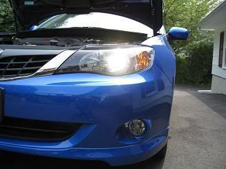

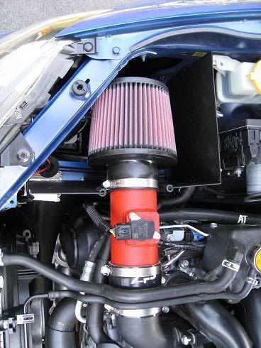

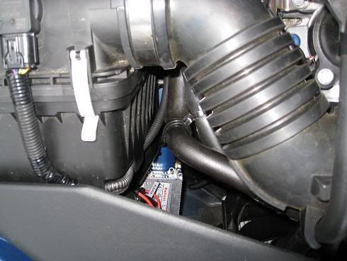

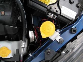

So I installed my hid kits , 4300k ~ The ballasts are stacked on top of each other on the upper frame of the car .
I did have to cut the tray for my short ram intake so it would fit , the ballasts were in the way . I'm so happy I didnt have to pull the headlight and retrofit it with projectors ......the stock low beam cutoff line is sharp enough for me with no glare.

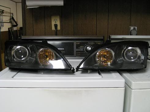

Here are a few of my true retrofits for the Escort zx2 , and focus that I've made and sold on ebay .

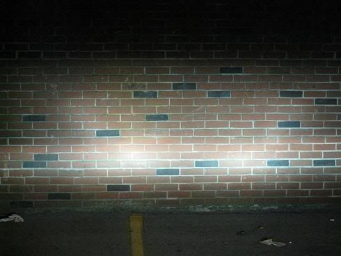

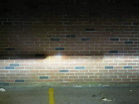

Heres a 4300k , low beam and high beam picture , enjoy .

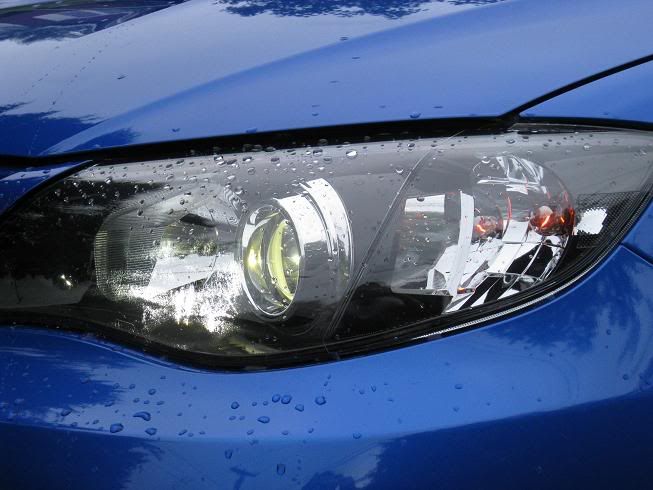

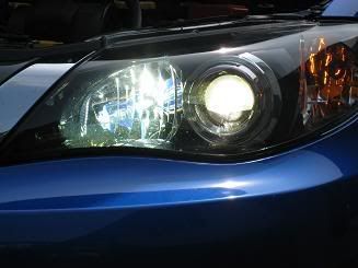

So after being high beamed so many times because of glare I retrofited my lights with TSX projectors , they have been on the car since 2009 .
