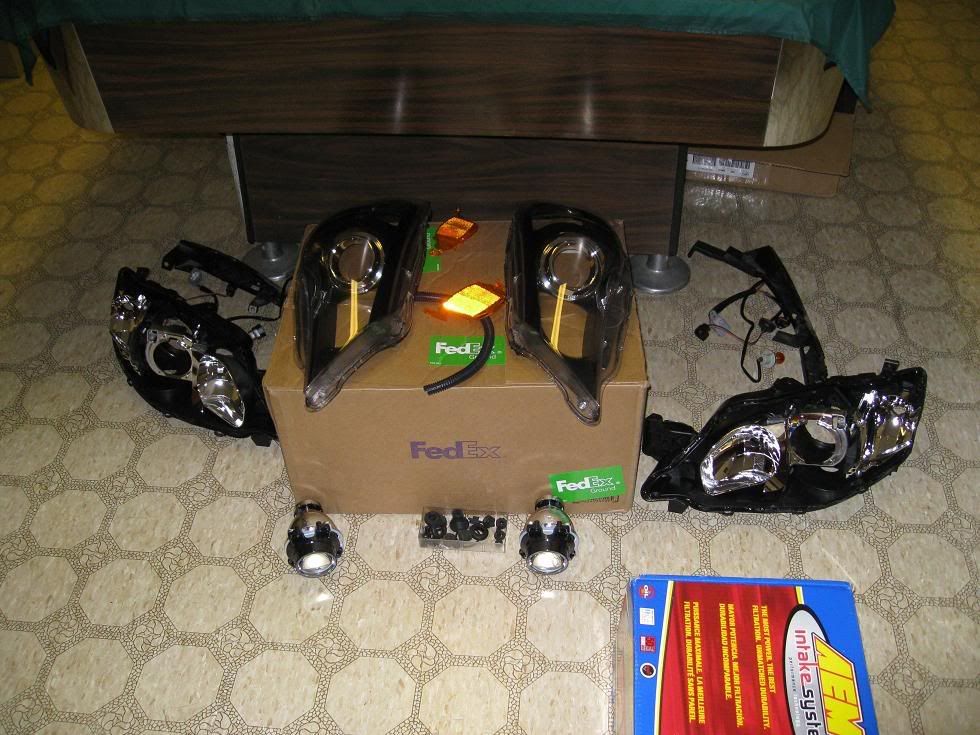

I got these headlights off of ebay , used but brand new condition off of a totalled 09 . I've done retrofits before , this one is the same as others , a projector swap . I'm still waiting for my TSX projectors in the mail. Just so everyone knows, the orange reflectors can be simply unbolted and thrown in the trash , so you can have that nice clear headlight . I've only dismantled them so far , so more to come when I get my projectors , see you in a week.

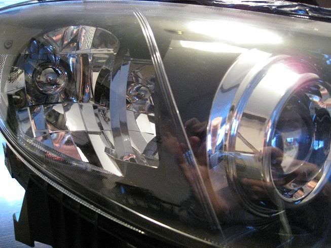

So its been a week and I'm all done , I wish I could put them on the car but its 24 degrees out and the rtv sealer is not fully cured , So I have to wait a few days .
Here is a picture of a 2008 oem light out put with a h11 HID drop in kit . (glare)
Here is my Tsx retro fit with d2s bulbs, and cleared corners with chromax bulbs . (no glare, sharp cutoff line)

It doesnt look any different from factory lol, But the no glare pic is deff. sick!!! wish I knew how to retro fit, cause id deff. do a set. Good Job

I want them to look stock , thats the point , I dont want a modified headlight ticket .
