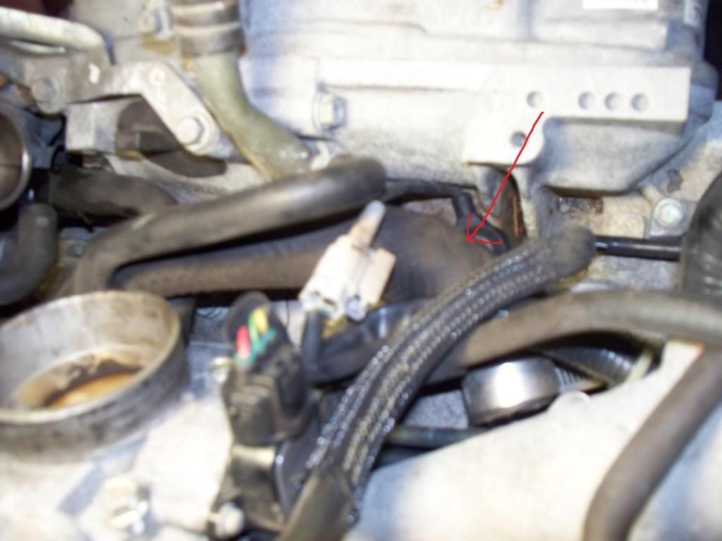

today i took my intercooler off just ### i was curious and i noticed that the turbo had a lot of black oily stuff in it and all the intake lines were kinda oily too. does that mean my turbo is toast? or is it normal?

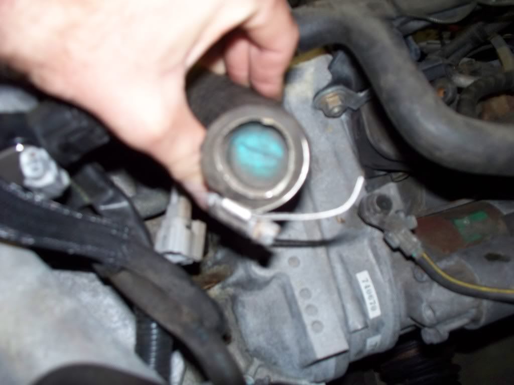

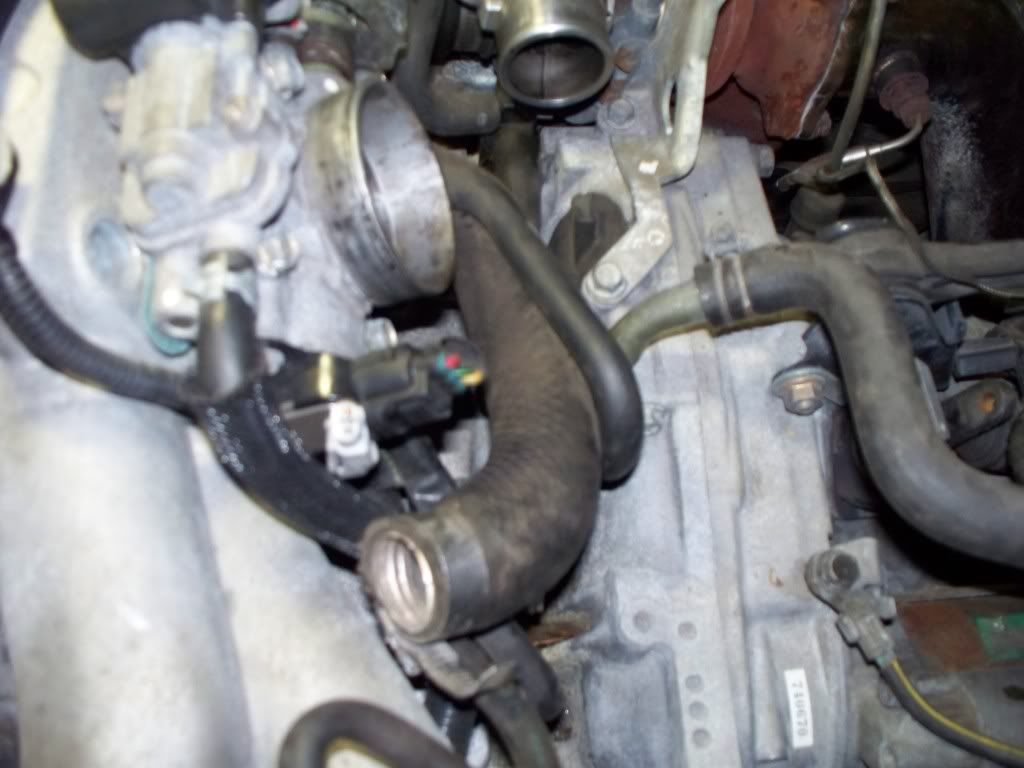

also i found a vacum line leading from my intake to behind the engine that wasnt attached to anything. upon closer inspection i noticed that someone had stuck a bottle cap in it to block it off. is it supposed to be like that or should it be attached to something?
where the hose was when i found it
Photobucket
after i pulled it loose
Photobucket
the bottle cap in the end
Photobucket

Oil coming out of the turbo compressor outlet is definetely a sign of bad turbo seal.
The line you are referring to with the bottle cap on the end is your recirculating hose to your BOV. I take it you have a VTA bov? I would get rid of that thing and get a stock bpv or a hybrid bov. (my dos pennies)
If you don't want to get a new bov, you can go to a local auto parts store and get a cap for it. They are made of rubber and expand when you tighten them to make for a better seal than that bottle cap.
