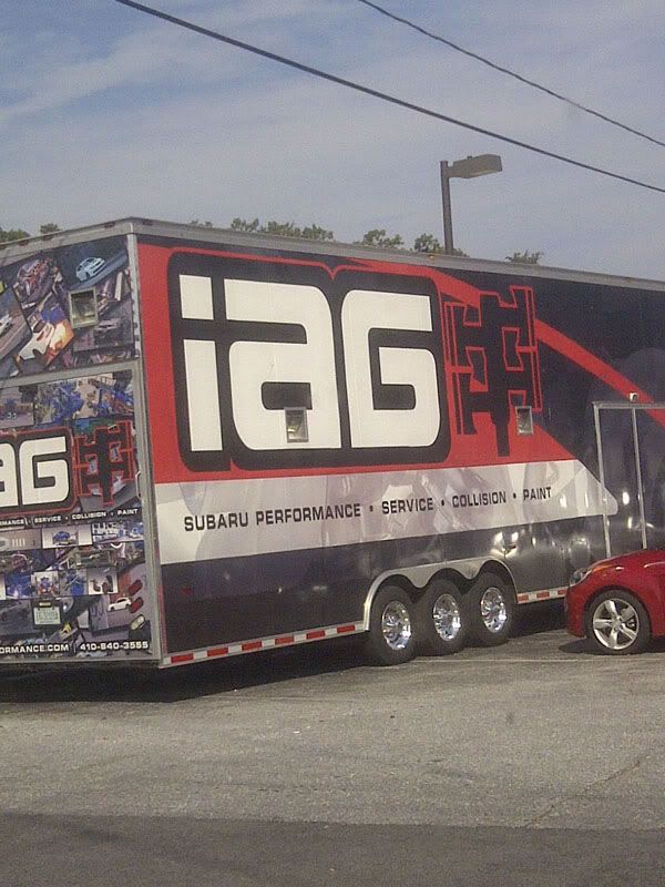

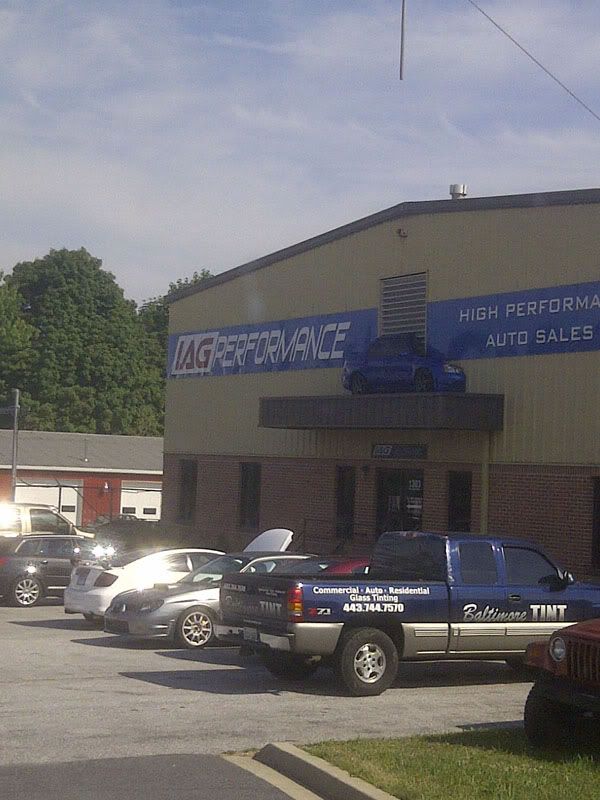

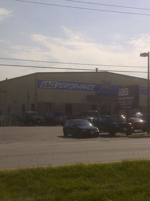

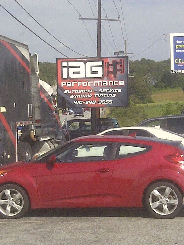

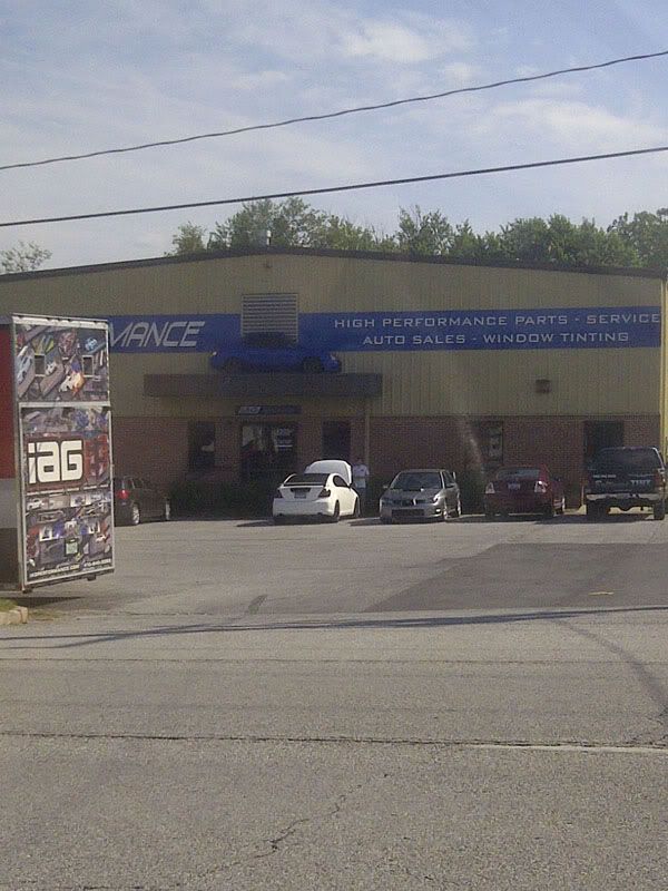

Just because my work has been sending me down to maryland lately. I happened to spot something today on highway 140.
Fixed the IMG tags...wahoo

That place looks oddly familiar, but I can't quite put my finger on it...
Believe it or not, I was actually there earlier today. Fortunately, you didn't capture my hooptie rental in any of your pics so there's no proof. I might or might not have dropped off some items and chatted with JJ and Rick for a bit. It might be safe to say that things are falling into place and I'll most likely be making it to the Hershey meet in September.
