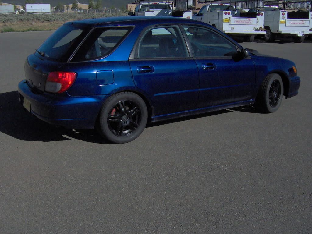

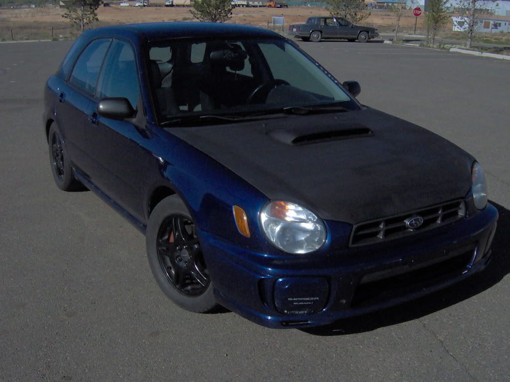

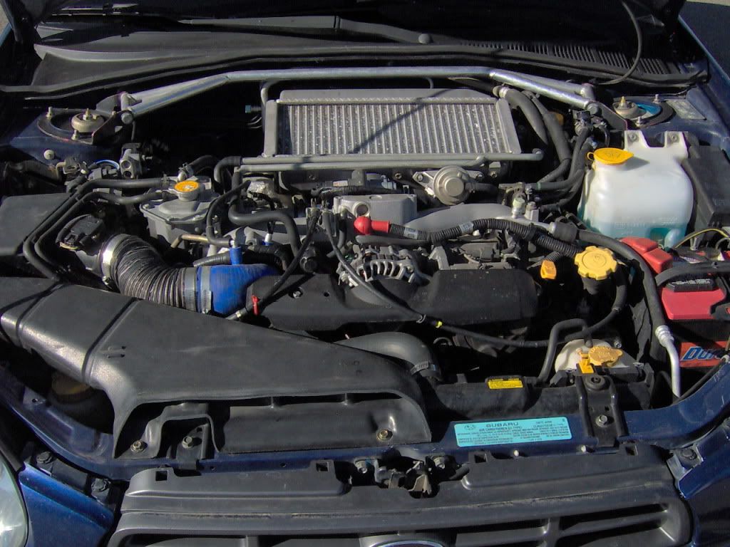

Well, I got my swap done !!
Quick history: Corvette runs red light smashes front end of my car, insurance company can't decide on totaling or repairing, decides on repair but me and the body shop don't want to chance it, I pay off car, retain for parts, find 2002 TS wagon with seized engine and rodent infestation for $600 in Oklahoma, tow TS home......
So I stripped both cars down to the bare shell, in order to get the wiring harness' out. I then built the TS shell back up with basically everything from the WRX. It took me about three weeks to do. Lots of tedious detail stuff. The engine swap was the easiest, so I saved it for last. That only took 1/2 a day !! Anyway here are pics. I'll get a chance to take it out on track this weekend at High Plains Raceway (Byers, Co) I can't wait to shake it out a little

BTW, that's the bent hood off my old car. I tried to get a CF one but the vendor was a loser. I'll probably get something soon. That's a OBS grill. I just happened to have one and liked it. I wonder how many Blue Ridge Pearl WRX's there are out there ??

TS's have drums in the rear and smaller front discs, so I dropped the whole rear end as a unit, sub-frame, trailing arms, diff, axles, hubs all at once. When I changed the front crossmember, I just dropped the subframe first and left the control arms on. I swapped everything except for the front subframe, which was a little tweaked from the accident. The TS was an AT car, so pedals and all are on the new tub. The only things I left on it were the gas tank (switched the WRX pump) fuel lines and hard brake lines.

You should paint the hood though, it's such a non-wrx-ie color. Flaunt it!
Thanks. I will paint to match when I find a straight hood. I may even get the dings taken out and get the whole thing sprayed. It looks OK in the pics but the paint is pretty tired with lots of scrapes (down to metal) and such. Just registered it
