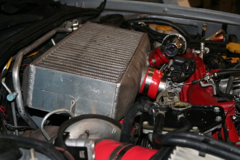

More pics...just like i promised.

I think i need that splitter....lol. Probably just laziness that they didn't realize its the measurements of the FMIC. I'd hope they'd have the right size for a TMIC. You can see in the pics how tight the Perrin is depth wise.
post #20 of 42 Old 09-22-2009, 10:34 PM
Is that metal line running above the TMIC your A/C line? It looks awfully close... is there any contact between the two when your engine rocks when you rev it?
post #21 of 42 Old 09-23-2009, 07:22 AM
It is the AC line and is Alumn. My Perrin TMIC contacted it and actually rubbed through the tube wall a little, which is one of the reasons I went to the FMIC even though I wanted the sleeper look..
post #22 of 42 Old 09-23-2009, 09:22 AM
^ Definitely something to keep an eye on, turmic. Aluminum is a pretty soft metal. I've heard of people bending the lines out of the way or maybe it would be possible to insulate the line with something soft at the possible contact points. Just wanted to bring that to your attention and maybe prevent a possible problem. What about that black rubber fuel line that looks like it's touching the bottom right corner of the TMIC, or is that not a problem?
post #23 of 42 Old 09-23-2009, 12:01 PM
The one at the bottom is a vacuum line... no biggie. Wrap the contact points on the AC line with silicone hose or take a small bit of the vacuum line you have too much of and do the spots.
post #24 of 42 Old 09-23-2009, 10:04 PM Thread Starter
Yeah, i'm sure the rubber hose is just a vacuum. Seeing as how it was described as a boost hose in the instructions. But, good eye on the aluminum. I'll have to wrap it or something.

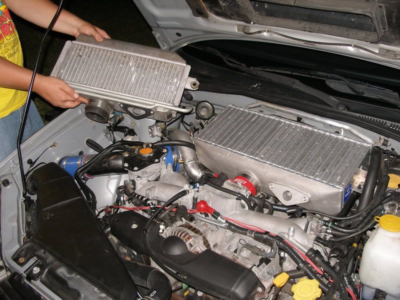

I was warned by Andrew (AndrewTech) that it will rub through Silcone after a short time. Ialso comment to him about mine rubbing the AC line to see if he had any ideas. I didn't try it to see just went with his opinion and pulled the TMIC, (not that I wanted more power either) I tried to adjust things but mine would not fit, Looks like yours fitts better, mine was about 4 years ago.. LOL..
Edit, more pictures to show the MASS of the Perrin TMIC..

Damn Shoaf...that looks a lot bigger under your hood. I wonder if they redesigned it some. No heatshield currently. I might put a SPT heatshield on there eventually. I think i'm definatly going to get a zerosports splitter though.
post #28 of 42 Old 09-29-2009, 03:34 PM
I took a brief glance at the TMIC again... would it be possible to remove a little material (maybe 1/4" to 1/2") from the intercooler-to-intake manifold pipe/hose in an effort to slide the TMIC down away from the A/C lines toward the engine a little more? It looks like you have a little room to play with those oval bolt holes on the brackets... or would that not work?
post #29 of 42 Old 09-29-2009, 09:40 PM Thread Starter
Maybe. Its actually not as close as it looks in the picture. I popped the hood to do an oil change tonight and i looked at it. Its actually far away enough, that i think it's fine. I just scraped the AC lines trying to get it in. Then i moved them out of the way when it didn't work the first time. I adjusted the one side of the AC line out of the way more tonight just to be safe. But, thanks for the heads up.
post #30 of 42 Old 09-29-2009, 10:41 PM
No prob.. just trying to help
I guess the angle of the pics make it look like it's almost touching.
