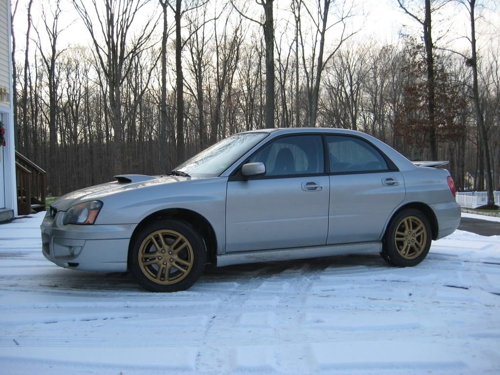

I'm about to do mine this weekend. I've got the hightemp engine paint, primer, and clear code. I really like the way the stockers look gold. I can't wait.

Did em this morning, thanks for the card trick GS!

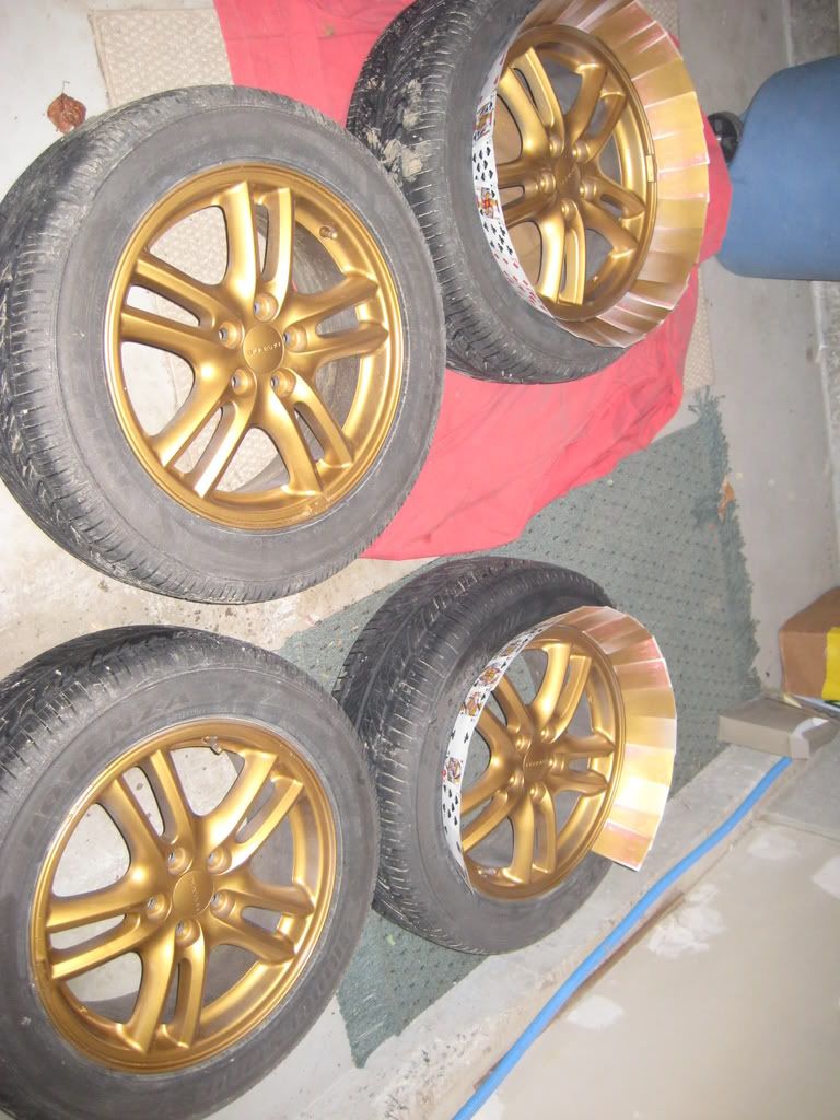

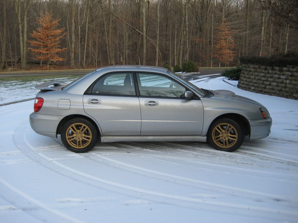

I love the way it came out. Looks great in person. I sanded it with 330 grit sandpaper just to enough to get the surface rough for the primer to stick to it. Took about 5-7min per wheel for a good sanded once over. Then 1 good coat of primer, 3 coats of paint, and 2 clear coats. Here's a few more pics:
