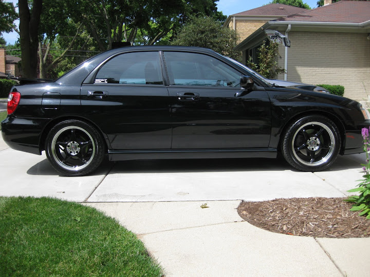

I went with TEIN H-Techs. The spring rate is a bit softer than the STI pinks. The look is good. I want to say that the ride has gotten rougher, so I think my struts are going. I've only got 34k on my car total, and about 8k running the springs.
I'll probably upgrade to KYB's next year.
+1 on the rear camber bolts. It made alignment to factory settings a breeze, or so the alignment guy told me. :-)

I am not a fan of the Tein H Techs. Yes, they are better than the HORRIBLE S-techs, but they are still not that good.
The H-techs for a 04-07 WRX Sedan specs:
Rates: Front 229 / Rear 196
Drop: Front 1.8"/ Rear 0.7"
IMHO, 229lbs/inch in the front is too much for the WRX struts. That high of a rate combined with a 1.8" drop in the front killed your struts. Also, the HUGE difference in the drop from front to rear results in a nose down/weird looking stance IMHO. The H-techs really are not a good match for stock WRX struts or GR2s. Also, that HUGE 1.8" drop takes the WRX McPherson strut setup out of it's sweet spot and hurts your handling (as I explained big drops do in my earlier post).
I would get good springs and new struts (i.e. GR2s, Koni Inserts, Dpsecs). If you go with GR2s go with a WRX style spring (as I mentioned in my earlier post) or if you go with Dspecs/Koni Inserts go with a STi style spring (i.e. RCE Blacks/Yellows, Prodrive Reds, STi Swift Sports).

Good stuff indeed. I researched for like 6 months before I got the TEINS.
I thought up to two inches was OK for stock struts. I guess not.
I'll see how this winter goes, when the temp. drops below 15 the roads get really rough. But they were rough with the stock set up too. In the spring when I get new struts it looks like I'll have to pick up better springs too.
I really dig how my car sits though.

Yeah, I agree... based on looks alone, I think that's just about the perfect stance. It looks pretty even front and rear with the tiniest bit of wheel gap showing - not completely slammed, but not a 4x4 either. Too bad it takes such a huge toll on handling.
