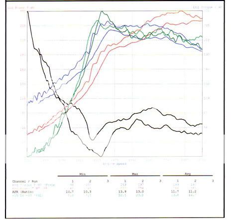

I'm scheduled to tune a 68HTA tomorrow morning on a 2.0L wrx. So I'll post up the results and possibly a video. I expect it should do pretty well, spooling a little after 4000 rpms, and pulling hard up top.

Well this is the same exact car which was previously running a 16g turbo, and now running the 68HTA. Other mods: FMIC, Injectors, Pump, TBE, UPP, CAI. The 68hta outspooled and outpowered the standard 16g!!!
68HTA - 272whp, 253wtq (22.1 psi peak)
16G - 254whp, 237wtq (23.5 psi peak)
