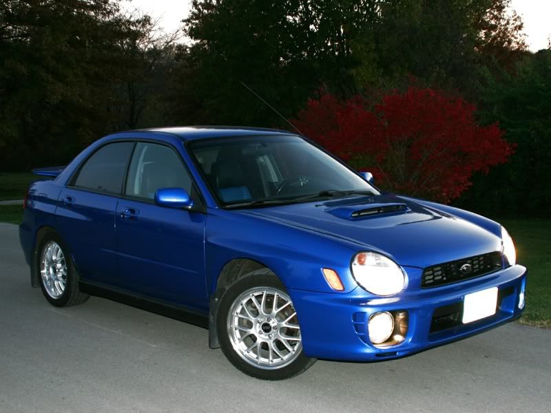

Those are the exact size tires and rims I have. They fit great and look wonderful!!!
