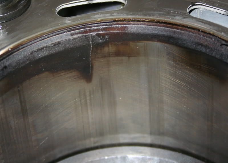

LOL. more then I care to really list.. But yea, I blew my stock transmission twice then gave up on rebuilding it.. I blew the stock 2.0L and a built 2.5L.. I'm currently in the process of building up a rock soild (so I hope) darton sleeved 2.5 with fully forged and ballanced internals. If only the Oil delivery system was good enough to rev it to the ballanced 10,000 redline..
What did the 2.5 have done to it and what went wrong and what was the cause? That's a lot of questions in one sentence
Forged Pistons and ballanced in the first 2.5L... I ended up cracking a Cylindar sleeve.. There is a small steel liner glued and pressed into the alumn block which is what cracked. I'm not sure what really happened.. I was at the drags when it blew but I was not really beating on it as I didn't need to to win my races.. I had an issure with an oil line blowing a month or so prior and I think it was just a combination of the oil stravation and stress..
