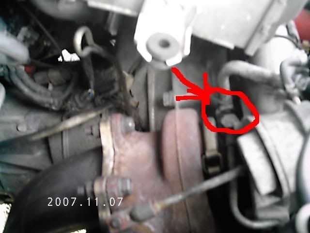

Then I have another problem with my coolant. It has been leaking and eventually it just keeps losing all the coolant so i keep refilling it. Right off of the turbo it drips down. Someone i met said i need a new O-ring. Does that sound right and if so how do i replace it?
Heres a picture of what im talking about

You're friend's sort of right. You probably need a new crush gasket (not o-ring). Try tightening that banjo bolt and see if it helps at all. You'll need to take off your intercooler to do that. Btw, why don't you have a ps ic bracket?

New O-ring maybe. Or just new and different Clamps. Mine use to drip after I changed the hose and new clamps no problems.

What do you use to get that hose off of the turbo and how do you get the intercooler off
