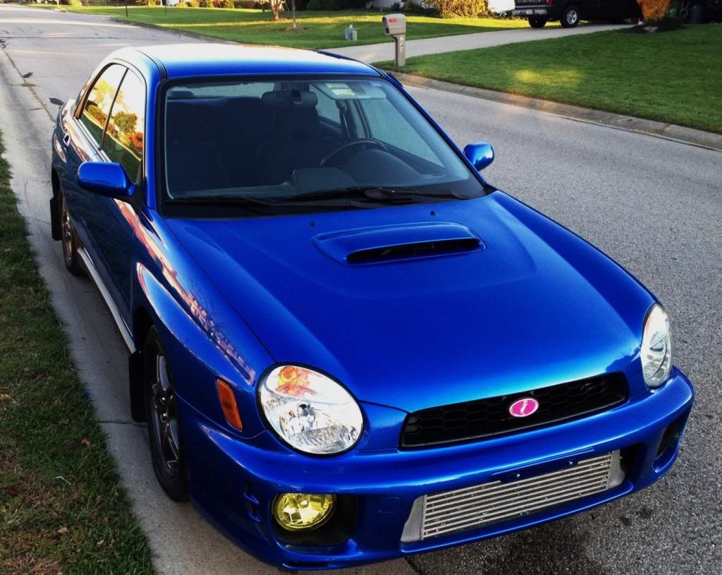

Just got my 02 hybrid swapped wrx yesterday . I traded my 04 rx8 for it . I'm still getting use to it . As far as build quality, the rx8 is way nicer overall IMO . It just feels kind of junky compared to the rx8 . It needs front fenders re clear coated. Has either a loud injector tick or down pipe leak . Runs and drives great . Not much more to add at the moment . I look forward to exploring the wrx community and this forum.

Looks good I'd like to see more pics. I like the mud flaps and the intercooler looks tight. Its always good to see a fellow Bugeye.
I'm not sure what hybrid swapped means. enlighten me.
Pop that hood! lets see under there.

yea
STi block with sti Turbo,injectors,ecu with wrx heads
popwar is offline
