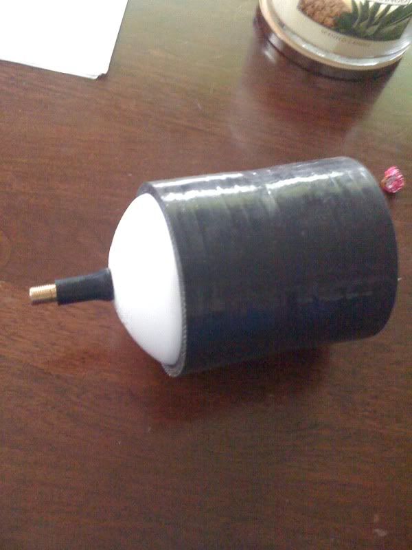

if your not hitting boost you have a few things to look for. wastegate malfunction, wastegate door operation, boost leak, the tune itself, stock 2-port or aftermarket 3-port operation just to name a few. if your sure you have no leaks id have to ask how you know? unless you hook up an air compressor via a home made cap thing you will never know forsure! that should be your first step. you can make one by using a CAI to inlet coupling, 2" PVC pipe end cap, drill a hole and install a tire valve stem from NTB.
once you start pumping the system up you will start hearing a loud hissing leak before you start to hear a low droan or a water bong sound thats your evap system kicking in. leaks are pretty easy to hear.

Always love when you put your home made flesh light up on the forums!Laugh!
