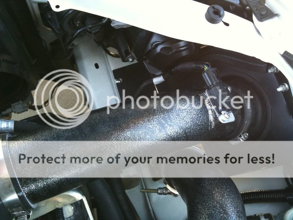

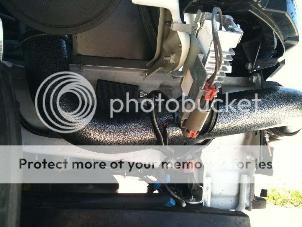

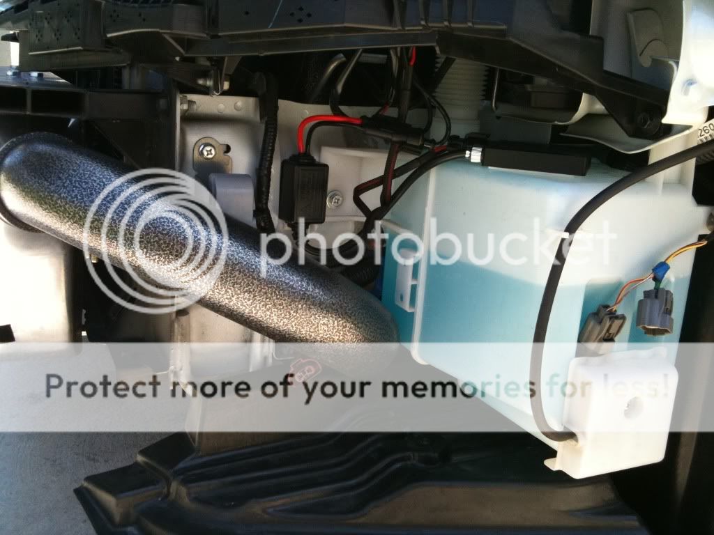

So Friday I drove to DDM Tuning and picked up a set of their 35 watt 4500k HID setups with the slim ballasts. An hour later I had the setup on, hidden and I can finally see at night. For the money, I think the kit is great. The light output is INSANE compared to stock...I ended up not drilling a hole in the cap and drilled a 1" hole in the bottom of the light behind where the stock power wire enters the assembly. Sorry for the crappy pics as the iphone is all I have...
looks so much better without the bumper on
driver side location
driver side, wires are hidden
passenger side location
passenger side, wires are hidden

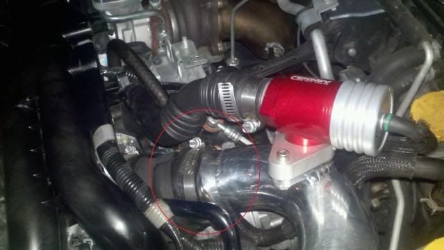

dude how did you go about getting the cuppler to stay on where your intercooler piping meets the throttle body(or intake manny which ever this is)
i absolutely can not get it to stay on. ive repositioned the elbow many different ways and this has slipped of 10 tomes (no exaggeration)

Judging by your picture I think my piping is shoved in more toward the throttle body. Did you try using the t-bolt clamp that came with the fmic? It looks like you have the stock hose clamp on there ( I'm running the stocker FYI) what kind of boost are you pushing? I've seen it hold 26psi without any issues. Did you ever pressure test everything to see I'd you have leaks?

thats shoved in as far as itll go. and whats a t bolt clamp. if its the ones with the 10mm nut that kinda sticks out perpendicular then i didnt have enough for that. im running like 22psi
