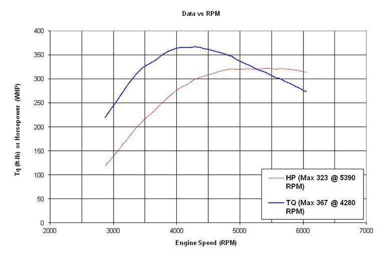

thought id post this up. Chris was nice enough to put a log into an air boy dyno for me. i have heard they read lower and Chris said close to a mustang dyno. i no my tuner has a brand new mustang and their old dynojet now. every car that has been on both right after another has shown a 15.2% difference in favor of the dynojet. id say these numbers are pretty right on because at the same boost with less parts on the dynojet my car put down 330hp/360tq. so add this, subtract that etc etc it pretty much works out. i do like that it works off more real world numbers, car weight, temp, humidity, wind, time it takes to go from X to X and it spits out a calculated number. cars not done yet, little more timing and boost i hope. maybe not on winter fuel but summer im sure we can! plus these 50 lb wheels/tires dont help.
Chris ill try to get a 2k to 6600 this week. not sure it makes a difference but whatever. i know full boost hits at 3300rpm, id like to see the tq hit around there too and not at 4300 rpm. im not sure if thats how it works or because i didnt punch it till 2900 rpm or whatever.
thanks a ton for everyone thats helped!! you know who you are!

I saw you're planning to run a few months on this tune. Don't you think it's worth going back given the weirdness with you A/F and the knock. Did you pay for the tune, or was someone just helping you out?
If you paid for the tune from a reputable shop, I'd head back. I'd hate to see you pop a ringland or something from the knock.

I'm still a skeptic until someone does a dyno run on a factory calibrated mustang dyno and plugs that log into airboy and it comes out pretty close. Otherwise I can't see a calculated run being accurate. A bumpy road or depending on when one person floors it vs how another person floors it for the log could really sway results.
post #206 of 315 Old 12-12-2011, 08:28 PM
blk05WRX's Avatar
Posts: 425
blk05WRX is known to be trustworthy and helpful blk05WRX is known to be trustworthy and helpful
I'm not sure about airboy, but I use Virtual Dyno. It has setting for a Mustang Dyno and a Dyno Jet. My run was within a few horsepower of Cobb's Stage 2 graph on their website.
My friends EVO came out with a 7 horsepower difference from the dynojet at AMS performance. We came up with 497 on the road and the dyno jet said 504. Pretty amazing.
Try it out and donate if you like it. He did a great job.
