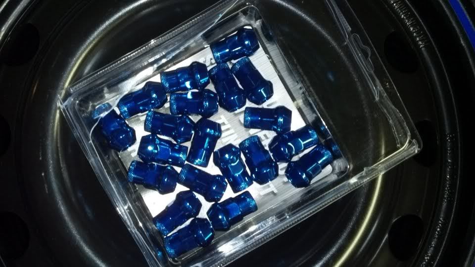

See you put the winter tires and steelies on. I bought some blizzak tires and steelies as well. But it was kind of plain to me and since I like the flashy look of the stock rims. I decided to make them a little more custom. I havent put them on the car yet since it only snow like a 1/2 inch a month ago and nothing is expected for awhile. So here they are sitting in the basement.

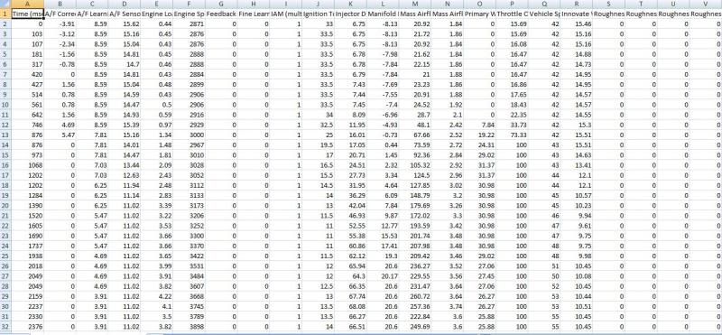

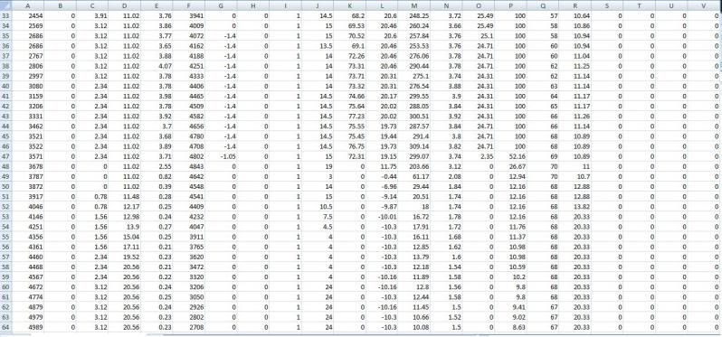

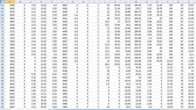

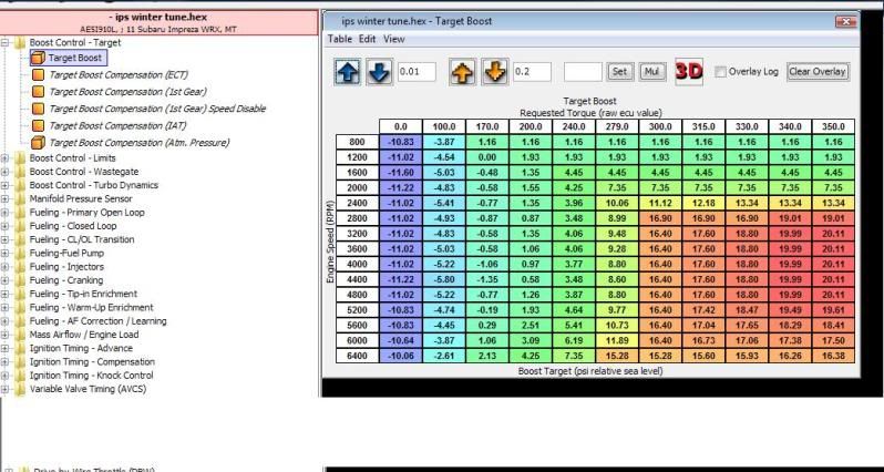

finished tuning today. gotta say i missed the power! even at part throttle with no boost it feels 1000 times more powerful with tons of grunt ready to blast off. i told him because of winter fuel and stuff we should maybe keep the timing down and not worry about huge power till april/may. he targeted 21 psi with i believe almost 16psi taper. im not sure though on the taper because when i got home i did a few pulls. i could only get up to about 4800rpm because at about 4200 my feedback knock correction (4 byte) was reading -2.8* on the first run and -1.4* on the second. after that i called it quits. this is my first time logging my car beyond stage 2 so im not sure whats up or if feedback is worse or better than fine knock correction. still reading up on that now. i know these cars hate knock but im not sure just how much. ill try to figure it out though! any advice ill take it.

ill look into it all now. but before then i hope people can see these...
first run
second log

Both logs are pretty consistent in showing that the ECU is pulling timing back from 15 when the knock correction comes in. So to me, it looks like too much timing or too much boost. I didn't see boost on your graphs. I'm assuming 21 like you said was your target, and that is a lot of boost. I've seen some tuners make more power with less boost and more timing. You just have to find the sweet spot.

Column L is his boot... Looks like about 21psi, which is pretty darn high even for 93. I'm only at 20.5 on E85 lol.
post #177 of 315 Old 12-08-2011, 09:53 AM Thread Starter
yes boost is column L. first log was hitting 21.33 and second about 20.60. boost is set to...
not sure what the top numbers mean for requested torque

ya i never saw knock on stage 1 or 2. i am worried i still have OEM plugs. i mean my 09 put down 330hp with less parts then i have now. i am CERTAINLY well over 100hp from stock! it for sure doesnt look like phanton knock to me since its constant and not at the start of the run.
just tried a run a minute ago. -2.8* same time, same thing.

yes and the log i just did, 15* hit -1.4* for a column then -2.8* for the rest and it dropped it to 13*. i do know the boost vs timing thing. lol i have no idea what to do with it though.
