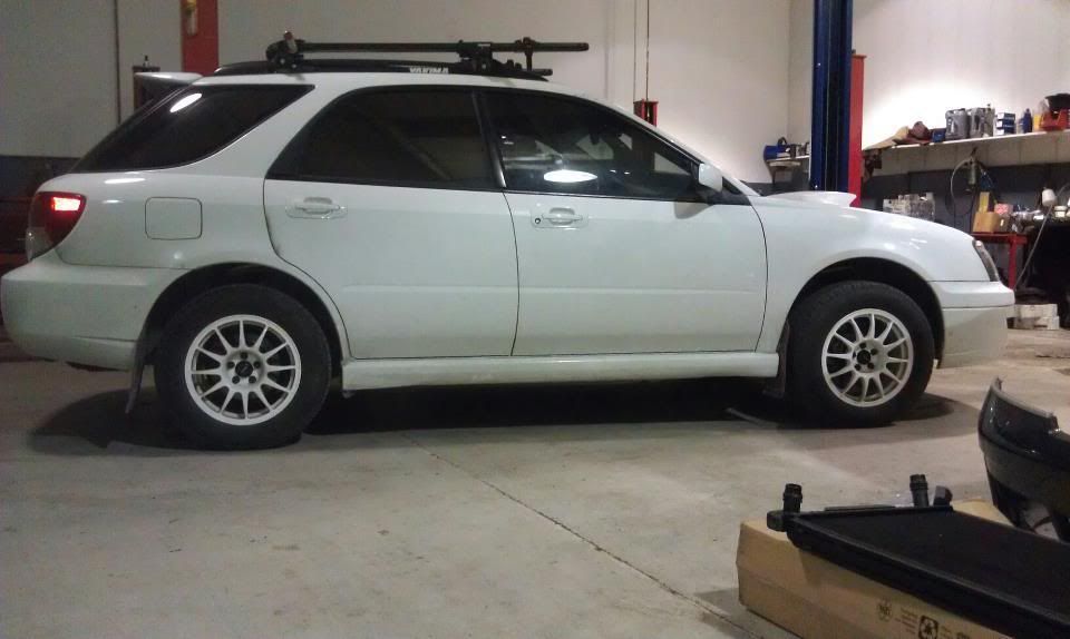

On another board, they were talking about using stock Forester suspension on their WRX's. I will look later to find the link of that thread. I did steal some pictures when I was on there.
Forrester suspension bolts right up to the wagon. Gives you room for about a 26" tire. A lot of people use snow tires. Only thing low profile you can really fit.

Ken, thanks for sharing those pics. Gives a good comparison of stock and lifted. I think that the subtle solutions would be the way to go for most. Doesnt look like a bad price either. You going to do the install yourself or not? If so good luck with it man.
