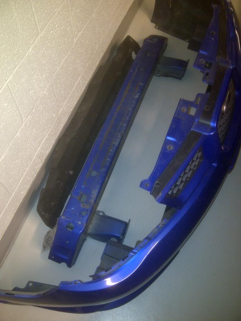

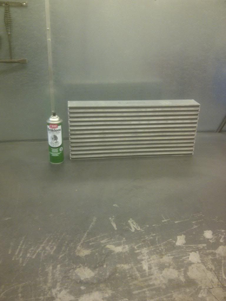

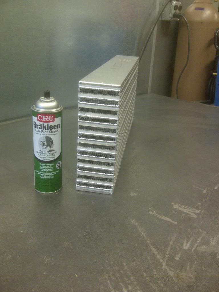

So, my tuner (Chad) let me know that my FMIC core came in and I swung by to take a look at it today. My crappy Blackberry photos are below. I added the brakecleaner can to the picture so you can get a sense of scale. Now, all they're waiting on is the metal and pipes. Brent, CBRD's welder will weld the end caps on and the pipes. But, they will test fit and mock it up a few times to make sure they're happy first. Oh...enjoy the crappy bumper beam picture at the end. LOL

post #141 of 174 Old 01-13-2012, 06:17 AM
Have them weigh that heavy bumper beam. Nice core BTW.
post #142 of 174 Old 01-13-2012, 09:02 AM
Posts: 2,161
Man, so much more room behind that bumper beam than the 09's.
You end up with a garrett core Mr. High roller?
post #143 of 174 Old 01-13-2012, 06:13 PM Thread Starter
Yes, a garrett core. Its the exact same FMIC core that is in the EVO that is in this month's Modified magazine. Chad said they'll probably have to trim the bumper beam still a little. But, yeah I didn't realize it had that much room. Garrett rates their cores and Chad said this core is rated at 800hp. Should be way more than what I need.
