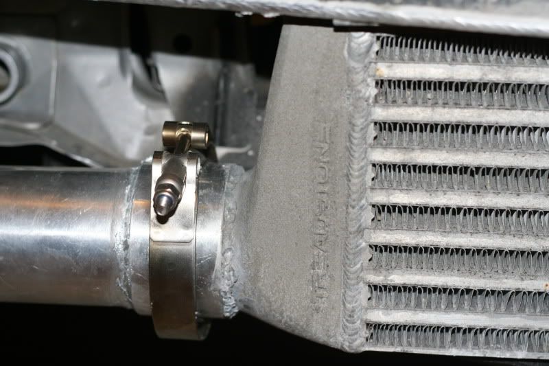

Buy a tig welder and teach myself how to weld
or
Take the pipes to a shop to have them professionally welded up now that I'll have them all cut and ready to go.
The brazing is just so sloppy it's making even me feel ocd about how it looks. I am wrinkle coating the pipes as well as painting the IC itself black so hopefully that will hide the joints a bit.

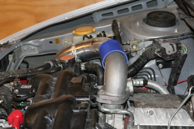

Made a tiny bit more progress today. I have the piece that will go into the throttle body pretty much done, I just need to braze a bead rolled edge onto it for the throttle body hose to clamp on to. From there I figured out that I will be able to run a pipe with a v-band under the headlight between the washer bottle filler neck, frame, and headlight. I had to cut a little bit off the washer reservoir (just some flashing on a piece of support) but other than that it will be in the stock location and everything.
I have stuff to do around the house today so I figure tomorrow I'll get back on it, I should be able to get the hot side mostly done tomorrow, if not 100%.
The only things I need to finish are an adaptor for the bpv hose (TiAL flange is too big, which I figured but the mfr said to get the bigger one anyways), coupler for the hot side pipe/turbo connection, and maybe a new hose for the throttle body as the 2.5" piping is quite loose in the throttle body hose. I think that hose is more like 2.75". If it is too big I'll just buy a 45* 2.75 to 2.5" reducer and it should be all set.

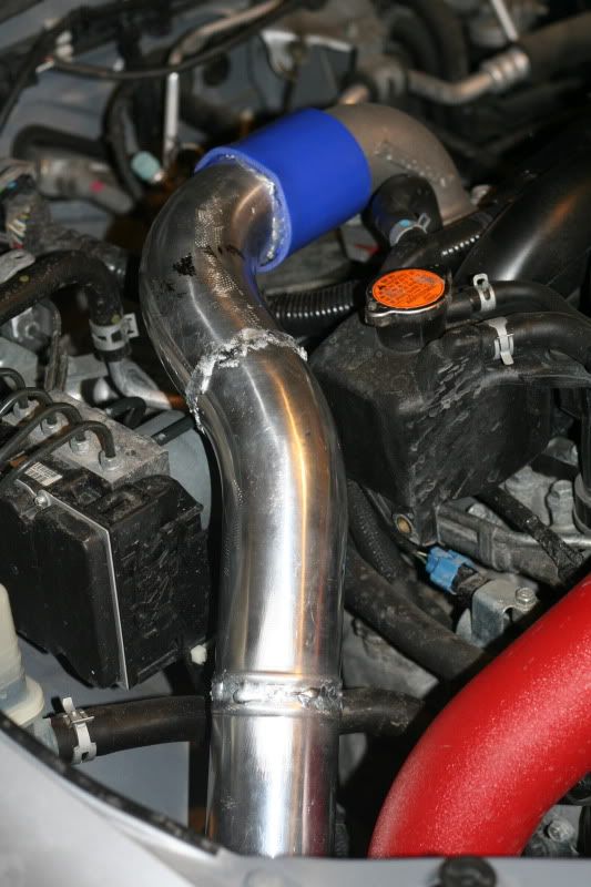

As for progress, I had to cut off the bend by the fog light on the passenger side. The pipe was hitting the lamp housing and wouldn't let the bumper back on all the way. I have to finish that piece, but only having two hands is seriously killing me. I have to hold a torch, brazing rod, and two pieces of pipe at the right orientation and I just can't do it. I know for a fact I would be done by now if I had a welder.
Driver's side I'm about 75% done. I have the pipe running from the intercooler, under the headlight, and popping out in front of the battery with a v-band. I have the bend from the throttle body done, I just need to make the piece in between the two and braze on the flange for the BPV. I lubed up the bpv hose and was able to fit the TiAL on the stock hose so that's good.

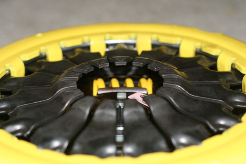

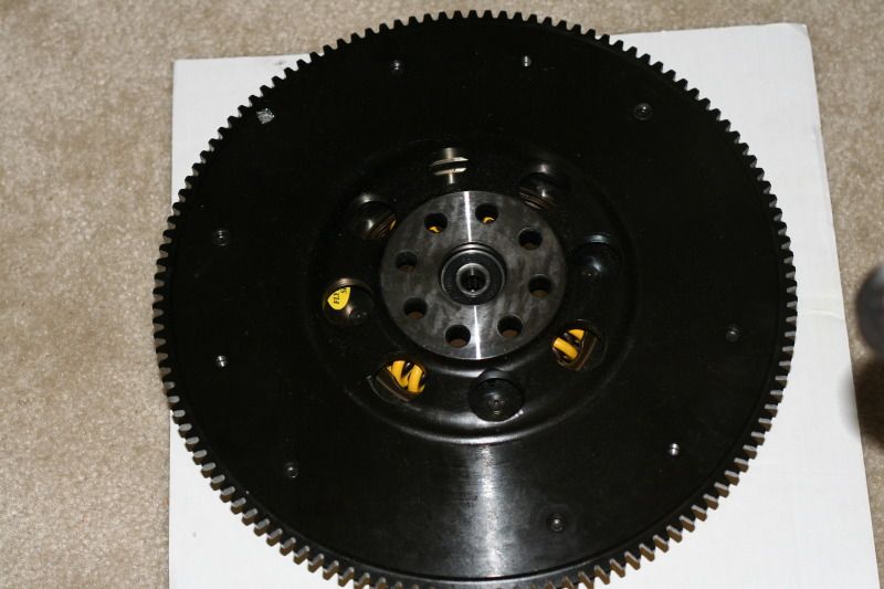

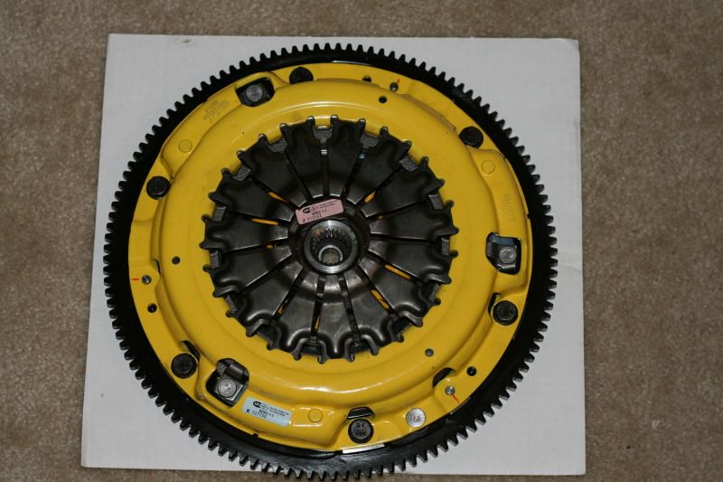

ACT HD Clutch and Streetlight Flywheel Assembled Pictures
Was bored today so I decided to put the clutch assembly together... Plus it was in three boxes and now that it's together it fits in one. Space is quite limited in my apartment lol.
Oil pan should be here next week, just need to find time to drive over and get it after work. A performance shop that isn't open on weekends? C'mon.
Whole thing
Sprung, full face disc:
Back of the streetlight flywheel with clutch installed:
