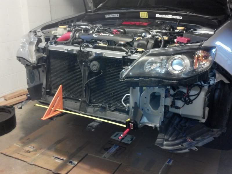

Up to no good......... Wife leaves me home and I get going on the project that's been on my mind for a while. I pulled the trigger today.
Any guesses or shall I elaborate?

looks like someone is mocking up a FMIC
Nailed it.
Not just any FMIC though......
Goals:
150% frontal area compared to Perrin TMIC (currenly 121 sq inches of core facing oncoming air) - goal of 185 or so square inches.
75% of core open to air (aka not covered by bumper or bumper beam)
What's that you said? Maintain stock bumper beam
No more than five couplers (one at throttle body, one at turbo flange, two at end tanks, one for cold side pipe). I should be able to make the hot side one solid welded pipe, and the cold side will need to be two pieces. That's it, less couplers the better.
I've been in talks with Mickey at Oswald Performance. He makes lightweight aluminum bumper beams as well as tubular subframes for the WRX/STI. He just got around to finalizing his 08+ WRX/STI bumper beams (front for now, rear coming soon) and I'll be using his bumper beam. His is 6lbs, stock is 19. I say in talks, I just mean communicating via email, no sponsorship or anything silly like that, just bouncing ideas off each other.
Stay tuned, the clutch is first on the list to cover (at least financially), then I'll tackle the Oswald Performance bumper beam and actually getting around to the FMIC/Piping. Damn me and my never, ever use credit cards to cover what I want to do to the car. Cash is king.
So far this is what I'm looking at for the FMIC/Pipes/BPV
Treadstone Performance Core/Endtanks - core is 8"x3.5"x24"
Piping - Bunch of straight lengths, few 90's, one 180, some more 45's.
BPV - Tial 50mm BPV. It's their new recirc BPV. I'll need to weld on a v-band flange to the IC piping but that's it.
All in I'm looking about $700 in materials and labor once I sell off the Perrin TMIC for pretty cheap. It'll be one hell of a cheap FMIC, and I get the fun of doing it all myself, with exception to the piping fabrication. I'll get them mocked up and cut, I just don't possess good aluminum welding skills or a tig welder.

i wanted to do something on mine when making the FMIC pipe but never did. how do you feel about moving the windshield washer fluid bottle to the trunk? since you have a hatch it will be easier. my bottle neck was to tall and would hit. if i could find just a square box from some car that would work better. you will be able to run the pipe easier and you wont have to cut the under tray or the drivers wheel well lining like you do with all the FMIC kits. plus the car will balance better moving 15 lbs to the trunk. hell move the battery too. one on one side and one on the other and its better balanced. just get a 15 lbs battery to match.

I'm.going to try and fit the pipe under the headlight and past the washer tank without touching it. I would love to shift 40+ lbs to the rear of the car but thats just too impractical right now.

Are you sure the light weight bumper bars will provide the same amount of crash protection as the original? Thats the only question I have.
post #284 of 432 Old 11-16-2011, 10:42 PM Thread Starter
Posts: 2,165
It won't. It's more along the lines of it's overall smaller so it'll be easier to fit the fmic, and it will basically mean I'm breaking even weight wise with the fmic setup. It may still be lighter than the stock tmic/beam setup in the end, and shift weight lower.
The main purpose of the beam is low speed protection, which the aluminum beam will provide more than all the typical fmic setups which completely delete the beam. I could probably keep the stock beam and it will work with my fmic setup, but you know me, the cash is there so why not
