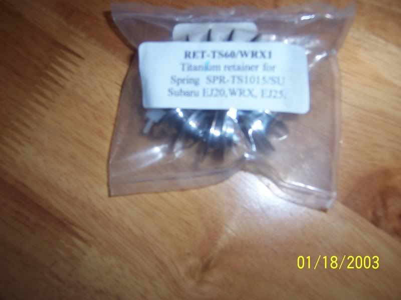

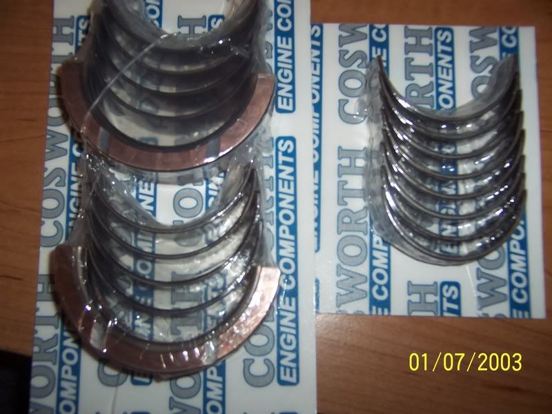

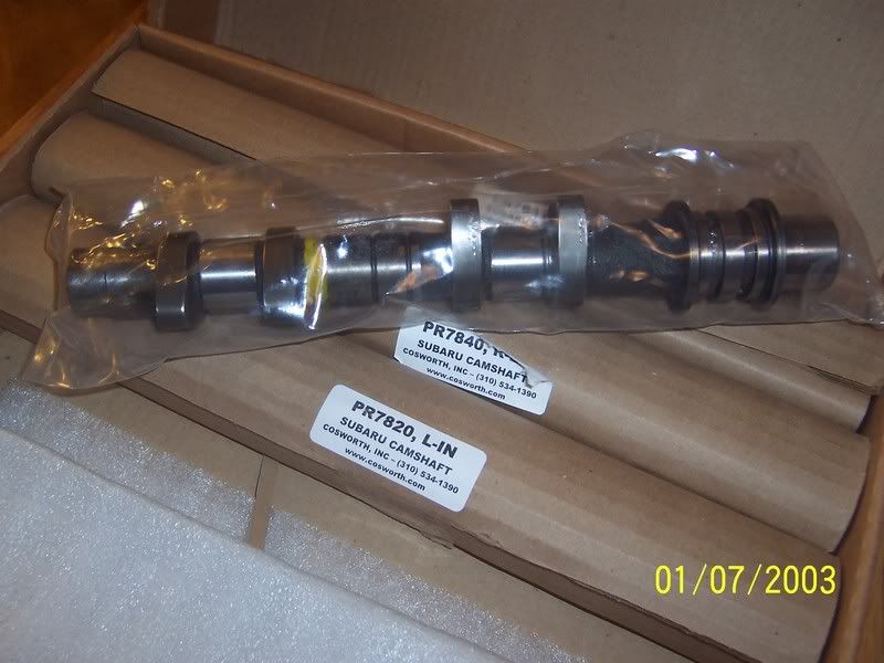

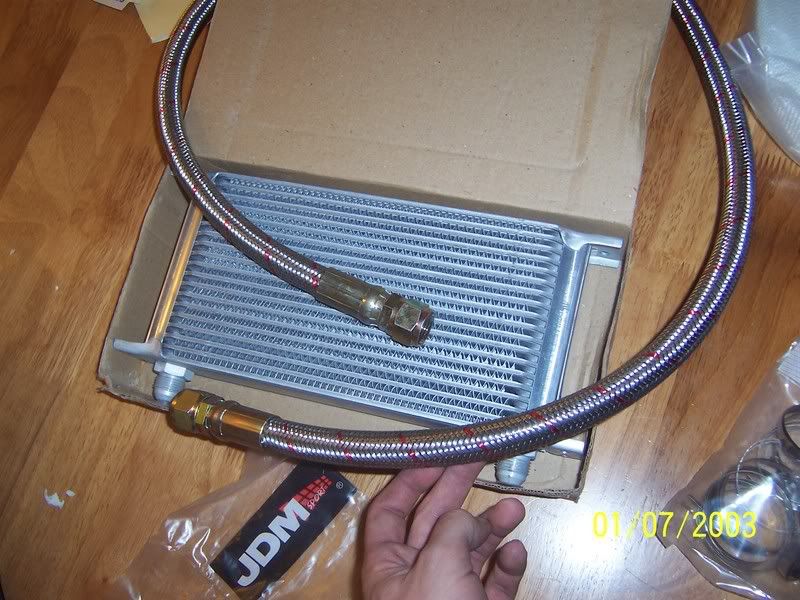

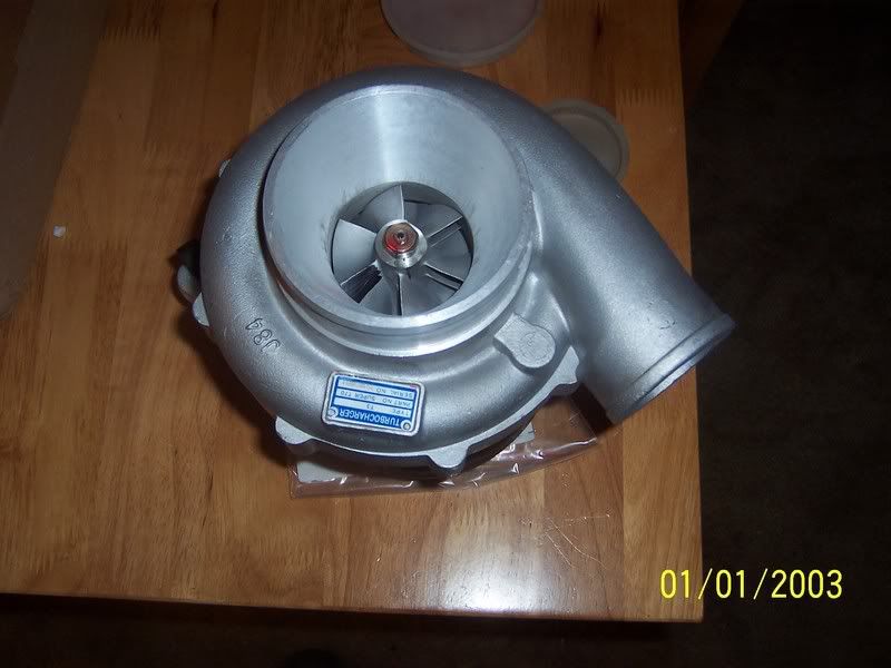

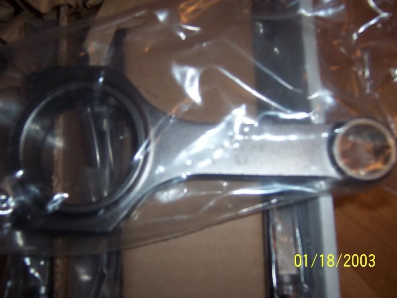

#25 ·
MUAHAH..

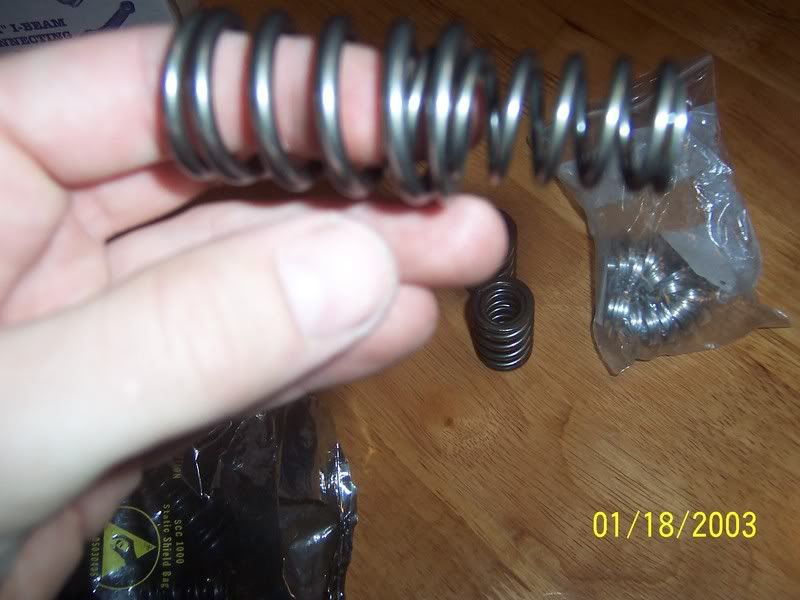

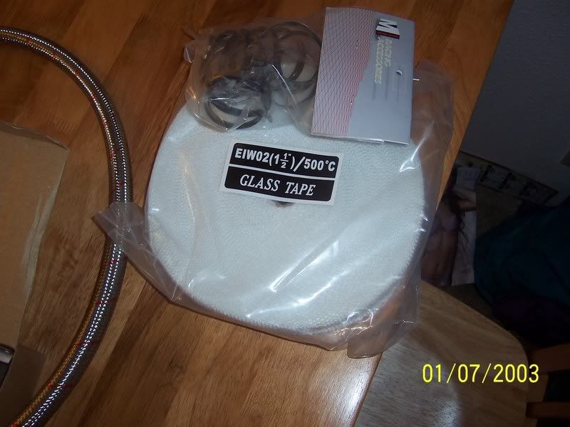

getting closer........and closer.... . I have part picts... :)
here goes :
T-70 turbo
Cp pistons
Kelfor Camshafts
Eagle H Rods
cosworth bearings..main and rod
oil cooler
exhaust wrap
SuperTech dual valve springs
TI. retainers
still have more ..just havent taken pictures yet..

parts llok good. that sure is a monster turbo. :rocks:
